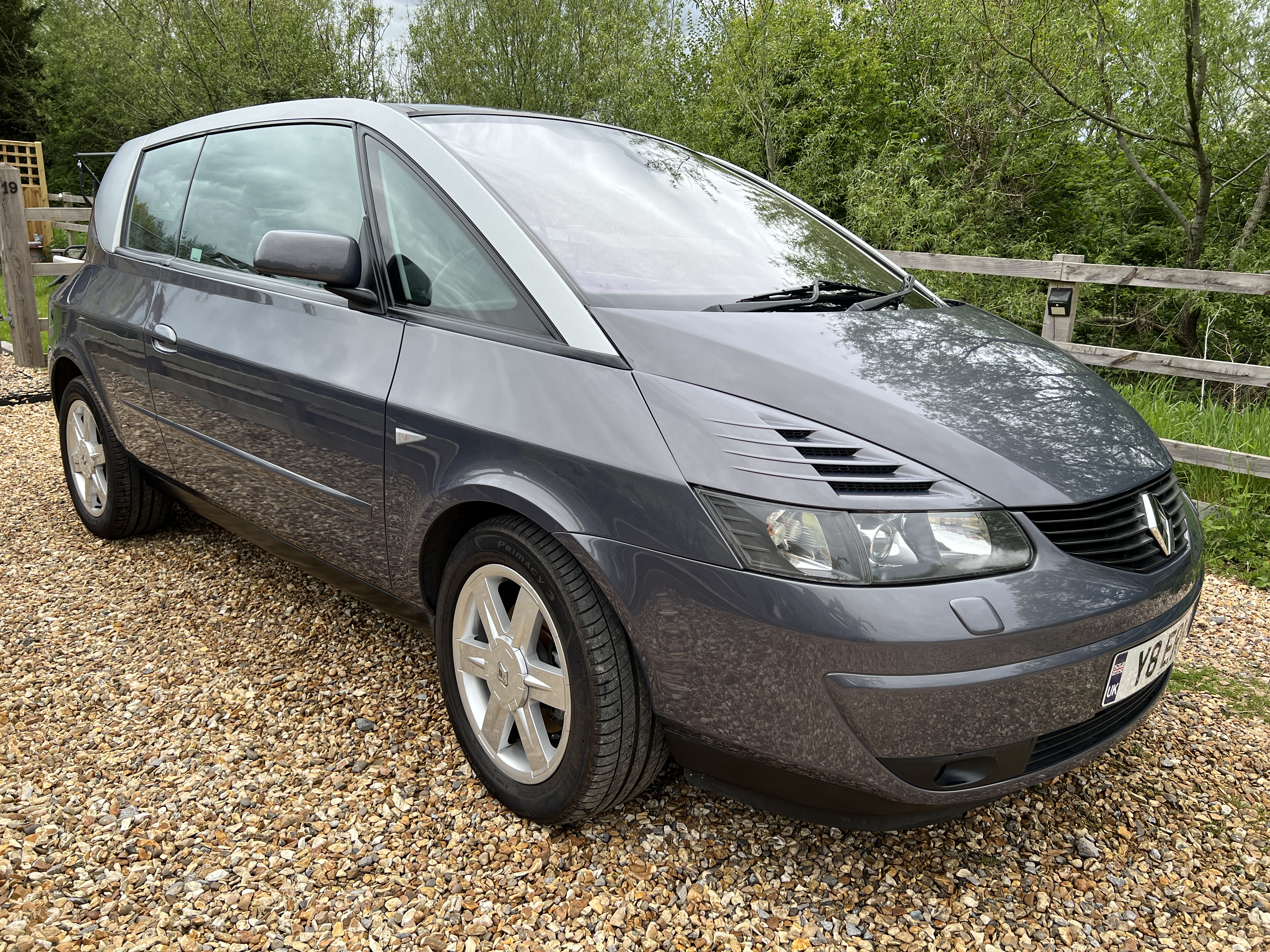

After the demise of my Nocturne and purchase of the grey EP2 thought I’d start up a thread of works to get it up to a better standard.
Whilst it’s now at only 29,000 miles, drives very smoothly not at all a harsh ride and superficially looks great the process has begun
In this week at my local trusted body shop it have attention to some scratching and marks it’s collected over the years.
Getting bonnet and both front side grilles over the lights, rear bumper and tailgate repainted, a number of chips around the door edges sorted and a mop and polish, for £1,000 plus VAT which I thought reasonable

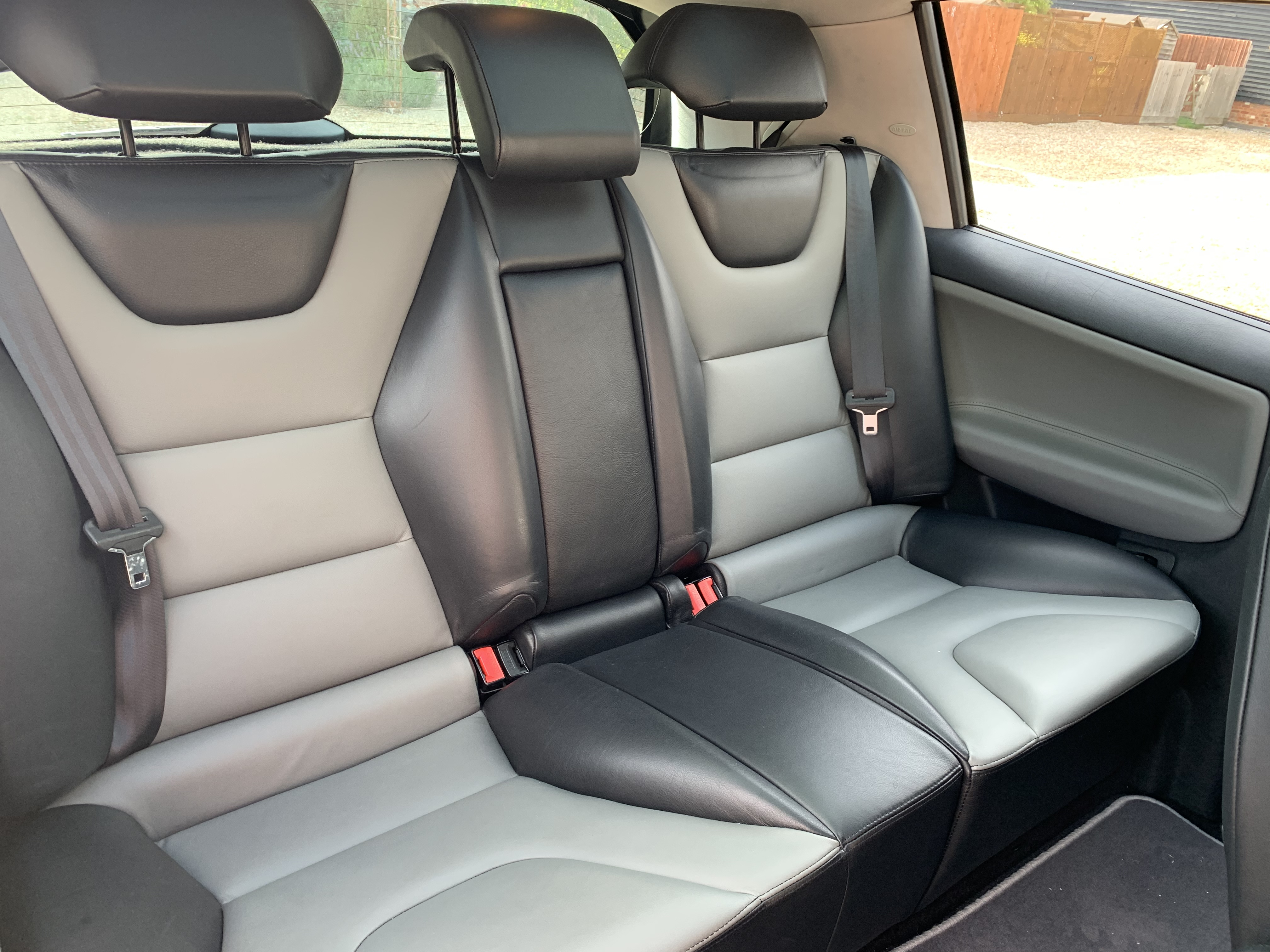

Early in August I’ve got a leather specialist going to sort out the tacky to the touch door handle and window switch panels and deep clean the EP2 interior

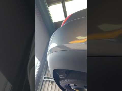

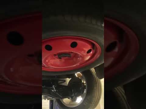

Then in Oct it’s off to Sandy for the full monty underside as you will see from the video it’s in need of some love and a new exhaust
Also discs and pads all round, cam belt change and full service and Sandy's door cill refresh

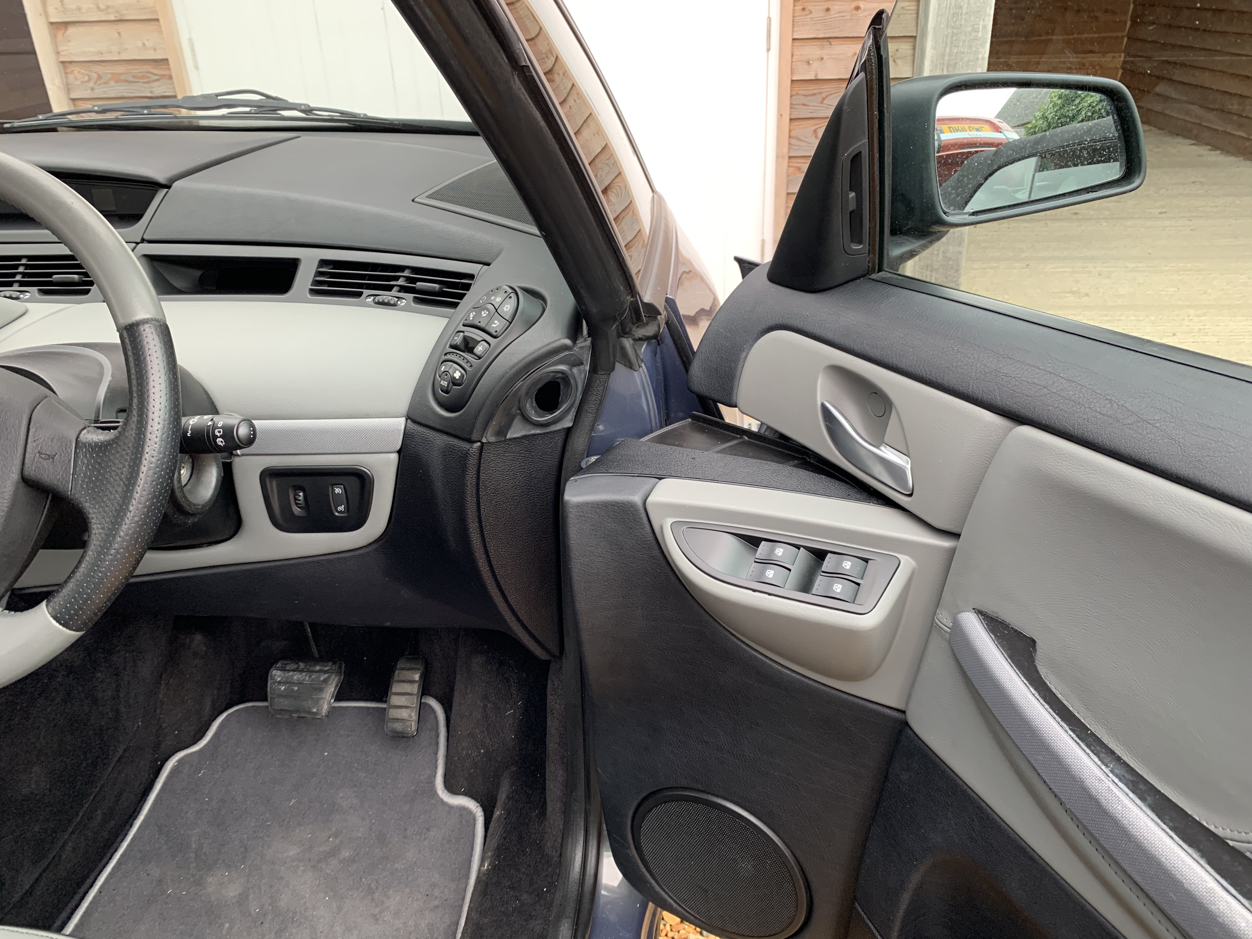

    I'm doing the same with my EP2 later in the year here in NL. It has exactly the same issue with the door handle area, previous owner must have had very long nails.
    Please post the 'after' pics and what your garage did to resolve? The rubber surface area isn't my problem, well documented here, but the door handle surround is the challenge.
    Hope all goes well!
  • Posts: 0
    Great car, well worth the time, money and work.
  • edited July 2021 Posts: 297
    Ahh thanks so much so it’s not leather just self coloured to match the EP2 grey
  • Posts: 0
    i can't guarantee the EP2 is grey plastic underneath....but the cream deffo is !!
    they probably painted the cream grey ! afaik that trim was never leather.
  • So got the car back from my body shop and the good news is new paintwork to bonnet, light grilles at front, rear tailgate and bumper are fab, chips on door edges sorted and mop has brought the sides up a treat
    Bad news is 18 year old paint has faded a tad so doesn’t quite match up so I’m biting the bullet and waiting for a quote to respray the sides complete and front bumper all to match, hey ho
    I want to get the car up to a top condition so not a lot of choice
    Meths purchased, hic, so will have a go over the weekend it’s definitely been painted to match the EP2 grey so will go carefully

    BTW with the meths give it a good soak and you'll find there is a point where the surface breaks down into a soft goo, too soon and no go, too long and it evaporates! Patience is the key..trust me it works. be prepared for using a lot of repeated doses but you'll get the hang of it after a few goes! And meths is cheap! 🤓 👍

    That's want I want to know, the colour of the underlying plastic on the door handle trim. Good luck and keep us posted bernie!
  • Since it's easy to remove the handle and surround, you could see what the colour is on the back. If it matches the EP front, practise meths on the back to ensure you're not removing the EP colour.
  • So gave a very gentle application of meths and very light rub to soak and it’s taking off the paint
    Going to leave it and let Sandy repaint when it’s up with him later in the year
  • After all he did a pretty good job on the Nocturne interior just a darker colour needed

    As I thought, the surrounds are all cream, just overpainted in whatever colour matched the E P interiors..either way for a cream interior they don't need repainting if the rubber gunk finish is stripped off. {unless badly damaged}
    That answers that question. Thanks for the photo! :-)
  • So my leather specialist came round and carried out a deep clean of the leather and also removed the trims to the door handle and light switches
    Fully removed the tacky coating on one of the door handle trims has now taken them all away to fully prep and recolour

    The cd and sat nav cover was badly marked from someone’s previous attempts at cleaning so using the meths, cloths and plastic scraper technique got the tacky residue off then applied some autoglym trim gel, not perfect but far better than the before
  • Posts: 0

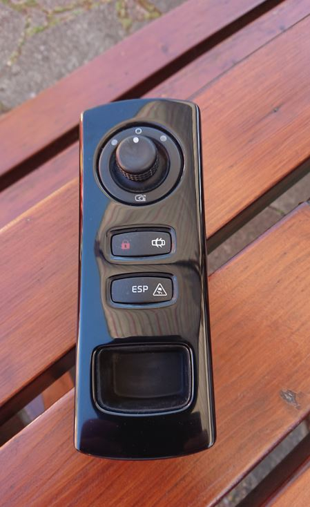

    fwiw the wing mirror /esp/ door switch surround comes up nice too...i used duraglit on all the hard black plastic, then polished.

    My leather guy returned today having completed the refurb on the panels and after refitting applied polish coat to all leather surfaces, to say I’m pleased is an understatement
